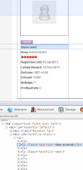

after restoring a backup from my online website on a local XAMPP sytem, all my Kunena users are marked as deprecated below the avatar. See the attached picture.
What does it means?

14 years 6 months ago #111296 by Matias
I must say that I have no idea on this either. There's nothing between online image and rank in the code... What happens if you try it in English?

About my question. I have found an answer. This is not a Kunena issue, it is a Joomla issue. Since J1.6 the SuperUser -and only the SuperUser- has the usertype "deprecated". This is a database entry (xyz_users -> SuperUser -> usertype). It has nothing to do with my backups. Sorry, I was confused :whistle:
Perhaps the Kunena forum should ignore and don't show this usertype..?
