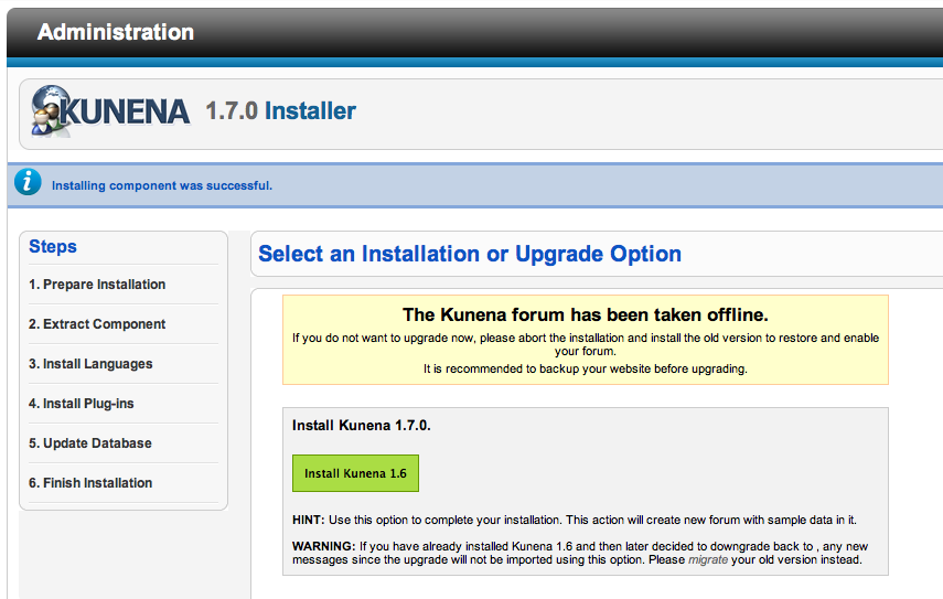

I'm running into a similar problem. I had an old Joomla 1.0 site with Kunena installed that I'm bringing up to Joomla 1.7. Here are the steps I've taken:
1. Install brand new Joomla 1.5 site
2. Migrate data from old Joomla 1.0 site to new 1.5 site
3. Upgrade Joomla 1.5 site to Joomla 1.7 site
4. Copy Kunena database tables (fb_) from old Joomla 1.0 site to new Joomla 1.7 site
5. Install Kunena on 1.7 site
Everything goes perfectly until I get to that last step. There is no migrate option displayed on the screen (just an "Install Kunena 1.7 option" that is not selectable, and an "Install Kunena 1.6" option that is selectable - screenshot attached). If I exit out of the installer, the forum is offline with no way (that I can see) to put it online. If I continue with the only option in the installer (install Kunena 1.6) it does appear to take me to Kunena 1.7, but with virgin forum data. If I try to copy over the old forum tables, I get a mysql error.
I've searched for migration instructions, and haven't found any that are working for me. Are me doing something stupid?

Last edit: 14 years 8 months ago by venture. Reason: Attached screenshot
