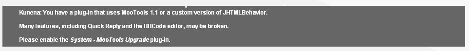

K1.6.0 Stable: Make your Kunena template to work when Mootools Upgrade plugin is disabled was created by Matias
Kunena 1.6.0 Stable does not enable System - Mootools Upgrade plugin anymore. Instead of that, default template calls now function that detects if plugin is enabled: if not, it enables MT1.2 anyway.
NOTE: If your template doesn't have initialize.php, there's nothing you need to do.
NOTE: This change doesn't affect sites, which upgrade from earlier K1.6 releases -- but it affects sites that upgrade from K1.5 or have clean installation.
How to make your template to work with Kunena 1.6.0 Stable
* Edit initialize.php and find the following lines:
To make it to work in RC and Stable, replace above code with:
If you do not need to support RC releases:
That's it!
// On systems running < J1.5.19 this requires the mootools12 system plugin
JHTML::_ ( 'behavior.mootools' );
// Template requires Mootools 1.2 framework
if (method_exists ( $template, 'loadMootools' )) {
$template->loadMootools();
} else {
That's it!

hi there..... ok what about template that hasn't got any initialize.php? i still got this problems, my menu were gone when the mootools upgrade plugin were enable.
any idea?
any idea?

Hi, put cunen and wrote me an error when I turn it off mootools slider = (.
Help.
