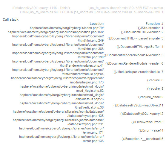

16 years 3 months ago - 16 years 3 months ago #58276 by Masoud
xillibit wrote: Hello,
You can try to enable the debug mode in Joomla! configuration panel, so see what's going under the blank page.
The snapshot of error messages is enclosed.
JDatabaseMySQL::query: 1146 - Table 'jos_fb_users' doesn't exist SQL=SELECT su.avatar FROM jos_fb_users as su LEFT JOIN jos_users as u on u.id=su.userid WHERE su.userid=64 LIMIT 1

16 years 3 months ago #58282 by @quila
I see that you have installed Kunena Login Module, this module version is not compatible with Kunena 1.6.
Uninstall it and problem should be solved.
With Kunena RC2 will be released new Kunena Login Module for this version of Kunena.

16 years 3 months ago #58289 by Masoud
@quila wrote: Hi,
Best Regards
I did uninstall the klogin module nothing has been changed, same problem is still present
16 years 3 months ago - 16 years 3 months ago #58296 by @quila
check if you have some other module or plugin for K1.5 and uninstall.
Reinstalling kunena could help also, maybe something went wrong on installation.
If that dont help you should enable Apache Server error log and look in that file what is exactly error with blank page, then report here what you find.
