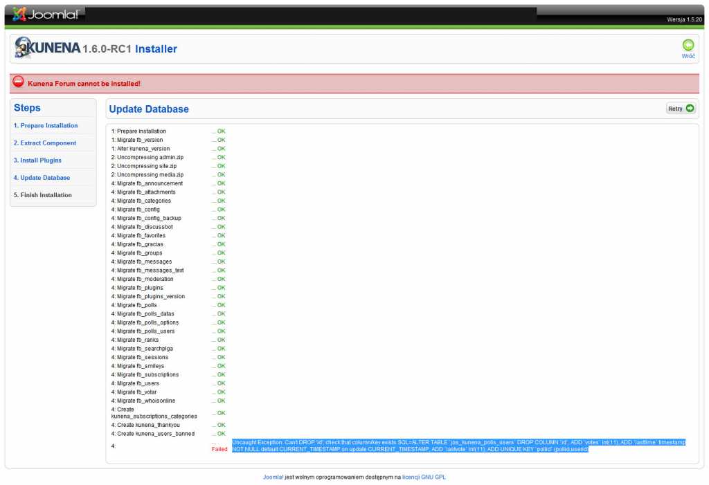

Hello, I have decidced to install Kunena 1.6 RC1
During migration I got an error:
Uncaught Exception: Can't DROP 'id'; check that column/key exists SQL=ALTER TABLE `jos_kunena_polls_users` DROP COLUMN `id`, ADD `votes` int(11), ADD `lasttime` timestamp NOT NULL default CURRENT_TIMESTAMP on update CURRENT_TIMESTAMP, ADD `lastvote` int(11), ADD UNIQUE KEY `pollid` (pollid,userid)
See screen.
My system:
joomla 1.5.20
See screen.
My system:
joomla 1.5.20
15 years 8 months ago #55632
by @quila
Replied by @quila on topic Re: Error during migration from Kunena 1.5.12 to Kunena 1.6 RC
do you have Poll Hack installed on Kunena 1.5.12?
Regards
Regards

15 years 8 months ago - 15 years 8 months ago #55636
by joomlauser
# Przeglądaj jos_fb_polls
# Przeglądaj jos_fb_polls_datas
# Przeglądaj jos_fb_polls_options
# Przeglądaj jos_fb_polls_users
I will remove them then try to install Kunena 1.6 RC1 once again, and finally see what will happen.
Replied by joomlauser on topic Re: Error during migration from Kunena 1.5.12 to Kunena 1.6 RC
Hi, I found tables in my database:@quila wrote: Hi,
Regards

15 years 8 months ago #55638
by joomlauser
OK. After deleting above mentioned tables, I installed Kunena 1.6 RC with success.
Thx for your tip.
Thx for your tip.
