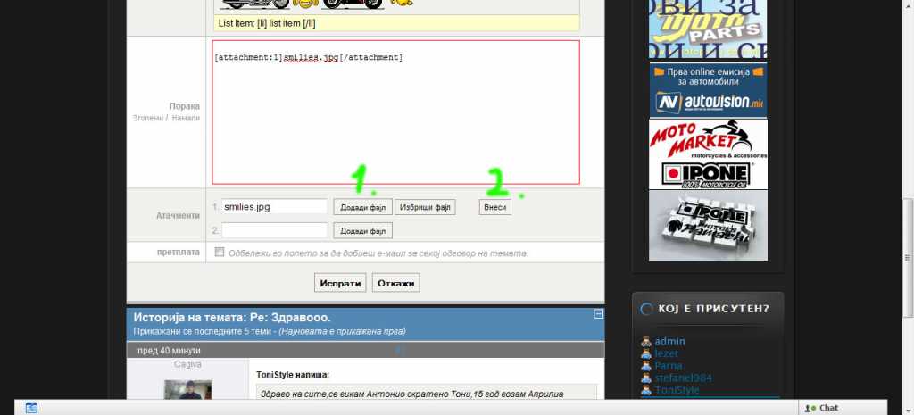

15 years 10 months ago #53474 by Baze
Also the image insertion into messages:
You have to click Add File, browse for the file, click ok on the dialog box, and then again click on Insert.
Can't we exclude the "Insert" button? I think it would be easier for the users if they just click on "add file", and ok on the dialog box and the string
[attachment=3344]image-insert.jpg[/attachment]
will appear into the message box.

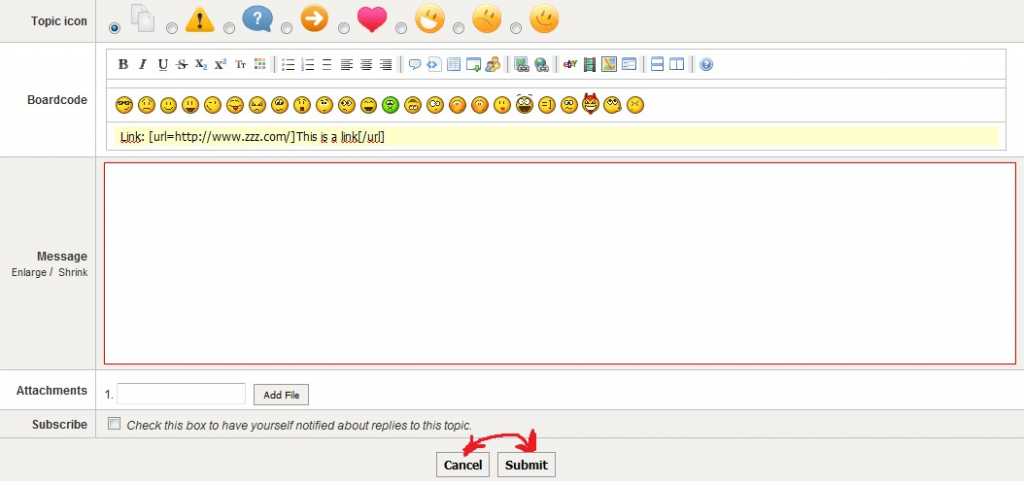

15 years 10 months ago #53478 by Admata
Baze wrote: By default in all previous versions (i'm using fireboard since the start of the forum which was back in 2007/8) the send button was on the left, and the cancel was on the right. So it's default action, you expect the send button to be on the left and you just click it even thou it says cancel :)
I agree and I think this is important issue! People read from left to right and therefore primary most used function should be on left. I don´t know any other forum that offers the cancelation first. And since 'Send' used to be where 'Cancel' is now, users will make mistakes and annoyance is unavoidable.

15 years 10 months ago - 15 years 10 months ago #54148 by ChaosHead
I do not understand, why Cancel button is on the first place. Therefore I suggest it to correct.
To change an order of buttons, in a file ...editor\form.php replase
<td id="kpost-buttons" colspan="2"> <input type="button" name="cancel" class="kbutton" value="<?php echo (' ' . JText::_('COM_KUNENA_GEN_CANCEL') . ' ');?>" onclick="javascript:window.history.back();" title="<?php echo (JText::_('COM_KUNENA_EDITOR_HELPLINE_CANCEL'));?>" /> <input type="submit" name="ksubmit" class="kbutton" value="<?php echo (' ' . JText::_('COM_KUNENA_GEN_CONTINUE') . ' ');?>" title="<?php echo (JText::_('COM_KUNENA_EDITOR_HELPLINE_SUBMIT'));?>" /> </td>
with
<td id="kpost-buttons" colspan="2"> <input type="submit" name="ksubmit" class="kbutton" value="<?php echo (' ' . JText::_('COM_KUNENA_GEN_CONTINUE') . ' ');?>" title="<?php echo (JText::_('COM_KUNENA_EDITOR_HELPLINE_SUBMIT'));?>" /> <input type="button" name="cancel" class="kbutton" value="<?php echo (' ' . JText::_('COM_KUNENA_GEN_CANCEL') . ' ');?>" onclick="javascript:window.history.back();" title="<?php echo (JText::_('COM_KUNENA_EDITOR_HELPLINE_CANCEL'));?>" /> </td>

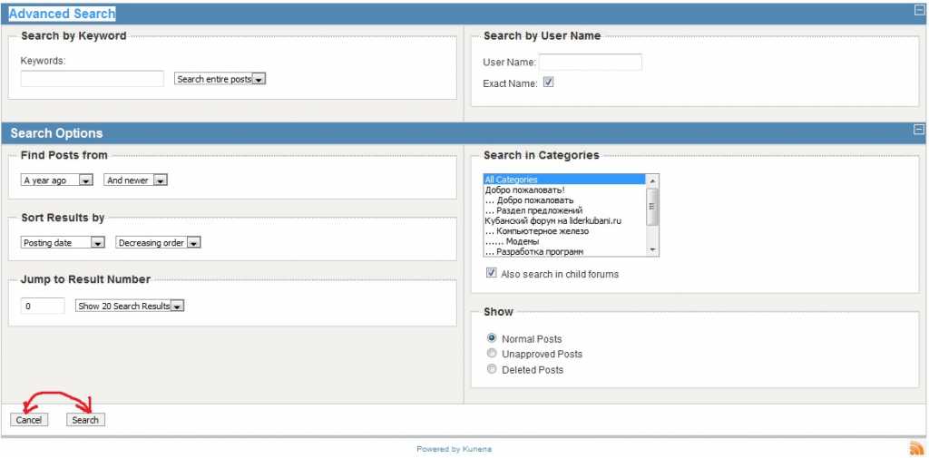

In Advanced Search
in a file ...search\advsearch.php replase
<td colspan="2"> <input class="kbutton ks" type="reset" value="<?php echo JText::_('COM_KUNENA_SEARCH_CANCEL'); ?>" onclick="window.location='<?php echo CKunenaLink::GetKunenaURL();?>';"/> <input class="kbutton ks" type="submit" value="<?php echo JText::_('COM_KUNENA_SEARCH_SEND'); ?>"/> </td>
with
<td colspan="2"> <input class="kbutton ks" type="submit" value="<?php echo JText::_('COM_KUNENA_SEARCH_SEND'); ?>"/> <input class="kbutton ks" type="reset" value="<?php echo JText::_('COM_KUNENA_SEARCH_CANCEL'); ?>" onclick="window.location='<?php echo CKunenaLink::GetKunenaURL();?>';"/> </td>
