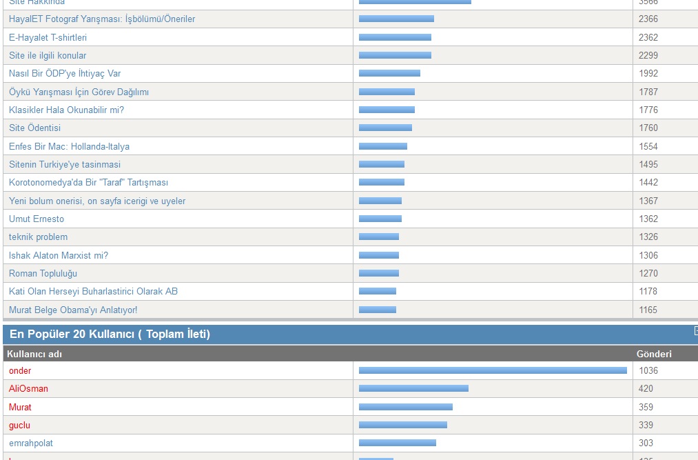

No our forum is active more than 3 years..we have more than enough postings to display..I am not sure is of you are asking that statistics but here how it looks

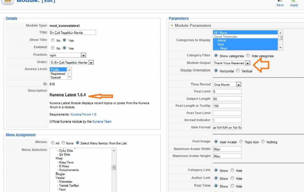

I am talking about mod_latest ver 1.6.4 NOT stats...Here is how my module setting looks..
15 years 4 months ago - 15 years 4 months ago #101789 by sozzled
Oh! I see! :side:
I've never used that option before! I think that the output is supposed to show you the the latest posts that you were thanked for (i.e. whoever is logged-in at the time) not who has received the most thank yous. It might produce a list of the latest posts from anyone that received a thank you in the last month. I'm not sure. Maybe someone else can tell us what your settings do? :unsure:
If you want to show who has received the most thank yous, you need to use the Kunena Stats module. I hope that helps.
