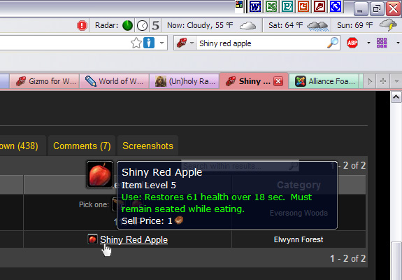

To clarify, this is what I'm trying to accomplish.
All I'm looking to do is create a mouseover tooltip whenever a Wowhead link is posted.
So, for example, if you saw this link:
http://www.wowhead.com/item=4536
Mousing over it would automatically produce a tooltip that would look like the following:
