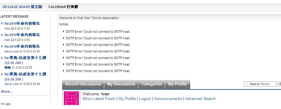

Just upgraded my Kunena forum from 1.0.8 to 1.5.11
Joomla : 1.5.18
Now pressing the "Submit" button, the screen displays SMTP error but the message was still submitted ok.
Please shed some light on how to solve this issue. Thanks.
