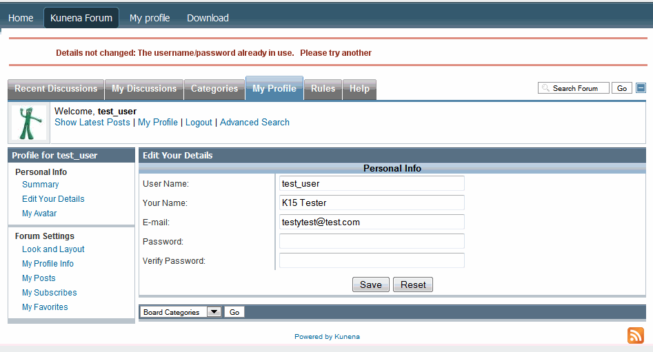

Good luck. When we discover which PHP module is responsible for generating the web dialog - actually, I think it's PHP, not Javascript - it might be a better solution to change the feature so that a success or failure error condition is raised by Joomla. I think it might be a better alternative to inform the user of their unsuccessful attempt to change their username as illustrated below:
What do you think? :)
16 years 7 months ago #44321 by sohost
Yeah, I think that is a cleaner way of doing it. Not just for looks, but also to having to rely on javascript for this.
