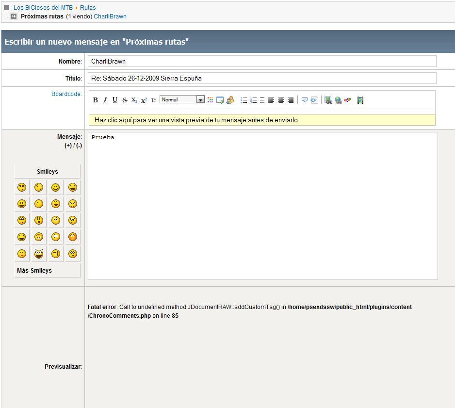

Hello friends, I have installed on my site:
-Comments Chrono 1.2 Component
-ChronoComments 1.2 Plugin
I installed the latest version Kunene forum version 1.5.7 and now I have a problem in the forum preview.
The error gives me is this:
Fatal error: Call to undefined method JDocumentRAW: addCustomTag () in / home / psexdssw / public_html / plugins / content / ChronoComments.php on line 85
and the problem is some kind of incompatibility with the plugin ChronoComments.php
I find that to disable the preview works fine, but then stops working the ChronoComments component.
sorry for my English... thank you very much for the help
To see if someone can take a look at the file and fix the little problem.

line 85 of the file ChronoComments.php, try to replace this :
$document->addCustomTag($js);
by this :
JApplication::addCustomHeadTag($js);
But i have just tested, with kunena 1.5.8 and the last version of chronocomments and i can't reproduce the issue.

I've tried what you say and has not worked, now reads:
Fatal error: Call to undefined method JDocumentRAW: addCustomTag () in / home / psexdssw / public_html / plugins / content / ChronoComments.php on line 86

fixed, thank you very much.
i replace $document->addCustomTag for this JApplication::addCustomHeadTag in line 85-92.
