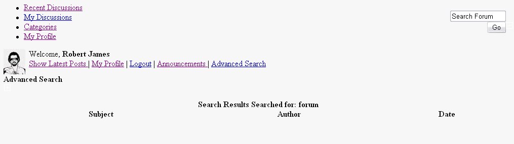

Hey All!
I have been unable to get the search feature on my forum to work. No matter what word or phrase I put in the result is nothing found. Is there something I need to set on install for this search feature to work?
Thanks for your help!

17 years 1 month ago #29705 by zombiebob
my search feature breaks the template :S
i.e. when a search is done, no results are displayed and the results table doesnt use the template :S

17 years 3 weeks ago #30804 by zombiebob
ok so after a few weeks i've had time to read through that other thread a couple of times, the search problem herein described (for me) is realated to mb_substr() function...the above referenced thread decribes how to fix it on a windows system, but i'm running linux, i'm locating the PHP.INI now (fedora core) and will post back here how i got on.
17 years 3 weeks ago #30806 by zombiebob
yep installing php-mbstring worked !
:laugh: :) ;) :silly: :side:
Ok so:
:blush: on windows based servers - edit php.ini and add
extension=php_mbstring.dll
:blush: on linux servers (that support YUM install) run
yum install php-mbstring
if you cant use YUM i'm sure you can figure out how to install mbstring functions onto your PHP installation,
:unsure: DONT FORGET TO RESTART YOUR APACHE !
