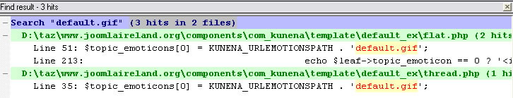

I just wanted to clarify, as this was an issue I was having and couldn't solve. I use Firebug all the time, but I don't know it inside out. I had no problem determining where the image was located. I couldn't however, find the file where it was referenced, using Firebug. Maybe you can help me there too.
I needed to find the file in which the image was being called so I could change the file extension from gif to png. I found a reference to it in flat.php in the topic emoticon array but it still wasn't working once I changed it. All the other images worked once I changed their extensions. I then asked Techbot to check it out as I wasn't getting anywhere.
Turns out I was missing the second reference to it due to the pretty but distracting colours of Notepad++ "Find in Files" results...damn.
image missing http://www.kunena.com/media/kunena/attachments/legacy/images/searchresults.jpg
So the least I can do:
For anyone else wanting to change the file format of the icons there are two references in flat.php for default.gif
line 51
and line 213:
echo $leaf->topic_emoticon == 0 ? '<img src="' . KUNENA_URLEMOTIONSPATH . 'default.gif" border="0" alt="" />' : "<img src=\"" . $topic_emoticons[$leaf->topic_emoticon] . "\" alt=\"emo\" border=\"0\" />"; ?>

Getting back to the specifics of the discussion topic, I'm pleased that left23 discovered where the default.gif image is referenced: there are two references in ../components/com_kunena/template/default_ex/flat.php and another reference in ../components/com_kunena/template/default_ex/thread.php. That, in effect, answers the question asked by techbot: "In which file is default.gif called?" Two files, three references.
