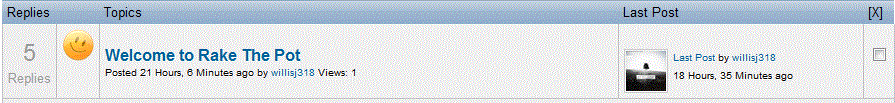

I'm having a problem and it is only happening with the current joomla template I am using. If i switch templates it is fine. I cant figure out which file i need to edit to get it back to normal.
If you want to see it on the site here is the LINK
Im assuming its something in the templates CSS since other templates dont cause this problem. But I cannot figure it out.
I have tried other Kunena templates with the same issue.
