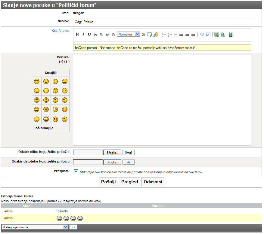

I have a problem with the default template to send a message, or not showing me how to smileys. I tried on another Joomla templates and everything is OK, but the Gavick Quay template there is a problem. I have no idea where to start solve the problem.
[img
and this small problems:
[img
[img
16 years 4 months ago #35230 by @quila
Hello vlado,
which template you are using? default or default_ex?
Postavi link ka stranici kako bismo mogli pogledati ;)
16 years 4 months ago - 16 years 4 months ago #35308 by vlado85
greeting
My page is currently under construction and not online, but here I will lock 3-4 hours to see. Template default_ex is replaced with changed colors.
I am entered in the following:
Original:
#Kunena table#fb_postmessage .fb_txtarea { width:95%; overflow: auto; height:300px; border:1px solid #ccc; } #Kunena .fb_txtarea { height: 300px; width: 95%; }
Original problem:
[img
My edit:
#Kunena table#fb_postmessage .fb_txtarea { width:644px; overflow: auto; height:15%; border:1px solid #ccc; } #Kunena .fb_txtarea { position:absolute; height: 15%; width: 644; }
Result:
[img
But problem with increasing the field:
[img
Link: www.rsplaneta.com/Forum.html
Whether it can be done to me smiles show in the line above?
pozdrav

16 years 4 months ago #35317 by @quila
reset you change then I can see where is the problem.
1. Apply this change www.kunena.com/forum/136-templates-and-d...urner-template#34674
2. Add this (red) at line 189
#Kunena select, #Kunena select:focus, #Kunena select:hover {
background:#F7F7F7 none repeat scroll 0 0;
border:1px solid #999999;
color:#000000;
font-size:x-small;
padding:0;
width:auto;
16 years 4 months ago - 16 years 4 months ago #35323 by vlado85
Thank you @quila, its work. ;)
