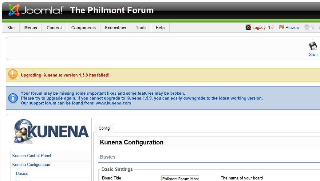

I have migrated my old Joomla 1.0.15 site to Joomla 1.5.15. Along with that migration I have also moved from FB 1.0.5rc2 to Kunena 1.5.9.
I started out by upgrading FB to Kunena on my old site so all messages would be in Kunena format in the db.
I installed Kunena on my fresh Joomla 1.5.15 install and brought all of the messages over with no issues - all messages are there and in the correct places.
On my admin Kunena console I have the message "Upgrading Kunena to version 1.5.0 has failed! Your forum may be missing some important fixes and some features may be broken. Please try to upgrade again. If you cannot upgrade to kunena 1.5.9, you can easily downgrade to the latest working version. Our support forum can be found..."
Screenshot attached.
What steps do I need to follow to fix this? Downgrade to 1.5.8 and then re-upgrade? I am confused since this is a new installation.
Thanks for any help!

Actually this problem is common when you migrate from J1.0 to J1.5: migrator tool is broken and breaks FireBoard (it just doesn't detect the issue and gets huge amount of new "bugs").
Please check that you have copied all the jos_fb tables and have indexes in them (you're missing at least one table).
To avoid further problems, I recommend you to remove all jos_fb tables from the new installation, copying all of them manually from old database to the new one and changing collation to UTF-8 -- all can be done in phpmyadmin. After that just install Kunena 1.5.9 again and it should work.

Once I installed Kunena on my clean new Joomla 1.5.15 site, I immediately brought over all jos_fb tables immediately from the old site. I don't think I can do this again as I've had users post since the migration and the tables will no longer match.
Will a "re-install" work? Do I need to uninstall first? Or just install over the top of what is there?
Thanks for the help!
