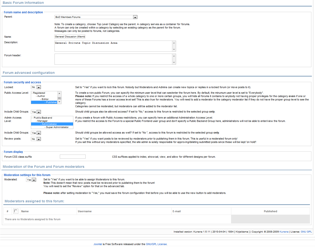

Catagory/Sub forum ( publishers only )
setiings for that look like image below:
if all of that is corrcetly set as above ( this is how my own live site is set so i know it works ) then sadly this issue lies with another compoonent/plugin or template that you have installed conflicting with kunena.
Last edit: 16 years 5 months ago by Cerberus.
16 years 5 months ago #50211 by cbrace
thanks for posting the image. After studying it, I switched the two "child groups" options to "yes" and then it worked as expected.
