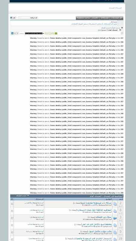

After upgrade to k 1.0.10 & Cb 1.2.1, I am receiving this error (check attachment) when I brows a category in the forum:
Warning: Division by zero in /home/abc/public_html/components/com_kunena/template/default_ex/flat.php on line 207
Warning: Division by zero in /home/abc/public_html/components/com_kunena/template/default_ex/flat.php on line 208
Any advice,

I also don't think it's related to J1.5.11, as the error showed when I upgraded from K1.0.9 to K1.0.10, and I was using J1.5.10 then, and I thought upgrading to J1.5.11 will solve it, but unfortunately not.
Anyway, the lines from 201 to 209 in /com_kunena/template/default_ex/flat.php is as fallow :
201 <?php 202 if ($leaf->moved == 0) 203 { 204 // Need to add +1 as we only have the replies in the buffer 205 $totalMessages = $thread_counts[$leaf->id] + 1; 206 $curMessageNo = $totalMessages - ($last_read[$leaf->id]->unread ? $last_read[$leaf->id]->unread-1 : 0); 207 $threadPages = ceil($totalMessages / $fbConfig->messages_per_page); 208 $unreadPage = ceil($curMessageNo / $fbConfig->messages_per_page); 209 ?>
Is it correct or I need to change something?
