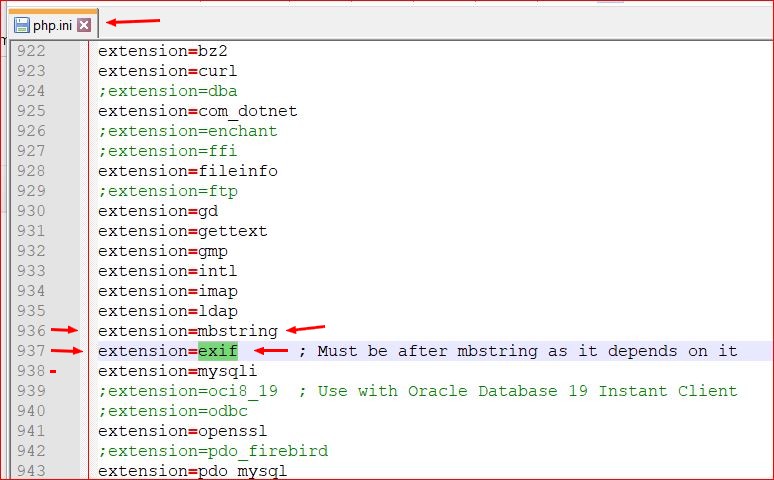

3 years 11 months ago #227007 by Leen
Replied by Leen on topic Image upload not possible
it looks like a php version issue you may be missing Your PHP setup is missing support for EXIF related functions.
check if you have these turned on in php version or in php.ini
mbstring and exifi is enabled
With kind regards
Leen
