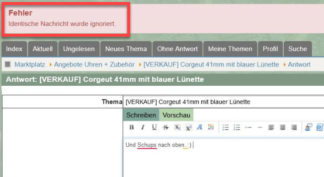

One of my users complained about about a strange error message:
For explaination: I'm running a small forum related to wristwatches. The forum contains also a small marketplace, where users can offer (or search for) watches. The user mentioned above has posted three different offers some time ago and now he wanted to push those offers. He tried to create an answer to all three posts with identical text (see screenshot), but gets an error message when he tries to do so.
I tried to reproduce the error in a different (non-public) category, but the issue did not occour.
Is this a known error? Or some kind of flood protection?
Thanks for you hints in advance!

6 years 9 months ago #212212 by rich
He will have sent the three messages quickly and successively.
Spam bots often post the same messages within a short amount of time.
Therefore, it's prevented to send in a minimum of time the same message several times, but if you wait some time, you can send the same message again.
Try it as a normal registered user.
It's similar. If you use the flood protection, it prevents you to send messages inside a chosen time period, indifferent which text the message contains.

6 years 9 months ago - 6 years 9 months ago #212213 by Ratman
rich wrote: Therefore, it's prevented to send in a minimum of time the same message several times, but if you wait some time, you can send the same message again.
Yep, you are right. I tried it as a normal user and then the same message appeared. Can you tell the exact duration the user has to wait until he can post the same message again? Seems to be more than 3 - 4 minutes.
rich wrote: It's similar. If you use the flood protection, it prevents you to send messages inside a chosen time period, indifferent which text the message contains.
Seems to be a good idea, but is it possible to turn it off in a DEV or STAGE environment?

6 years 9 months ago - 6 years 9 months ago #212214 by rich
I think it's relative, but it shouldn't take that long time.
The flood protection is default on off. But I see in your configuration report, you have set 15 secunds.

6 years 9 months ago - 6 years 9 months ago #212216 by Ratman
When I try to post while the timer has not run off: Will the timer start from the beginning again?
Yep, but the 15 Seconds are only the normal duration a user has to wait between two posts. The other duration when a user tries to post the same text again is much longer. It seems to be at least 2 minutes, but i will try to make some more tests to find out the exact duration
Last edit: 6 years 9 months ago by Ratman.
6 years 9 months ago #212220 by rich
It is not common for users to want to post the same content multiple times in a forum. This is more a typical identification of spam users. But when you add a space at the end of the next post, it is not identical anymore.
