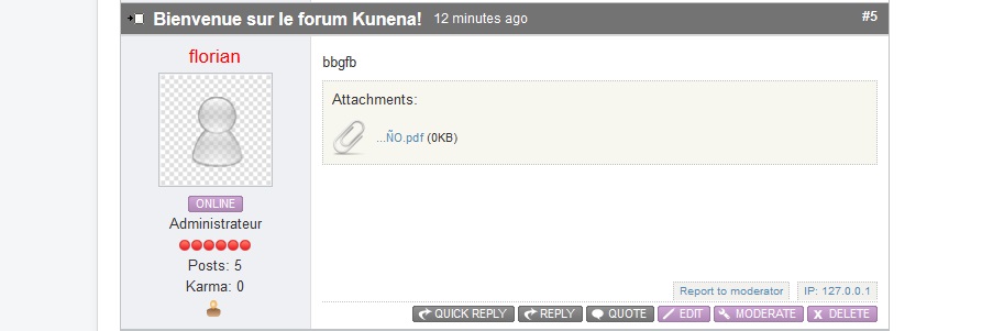

10 years 10 months ago #166715 by xillibit
I have tried but i'am not able to reproduce the issue :
The following user(s) said Thank You: ssh

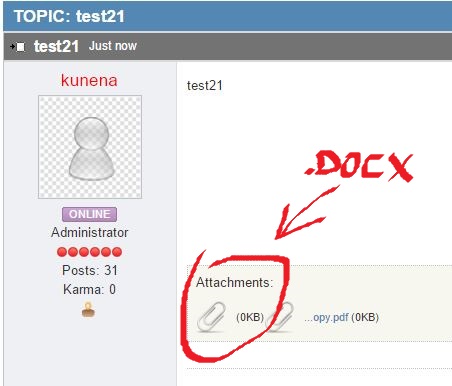

10 years 10 months ago - 10 years 10 months ago #166721 by ssh
Try with a .docx instead of .pdf
