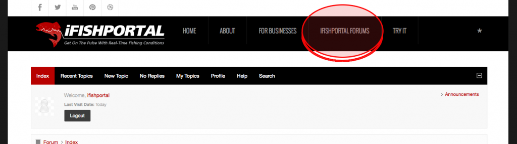

I installed Kunena and the main functionality works great. However, the active view in the main menu does not react correctly. Inactive state is the correct color, hover works fine, but when I select the forum main item, and I go to the forum main page, the forum menu item goes back to an inactive state.
Any idea why this is happening? See attached. The Forum main menu button should stay red (active)when I am on the main forum page.

12 years 1 week ago #160414 by mdraeger
now with attachment. basically, it doesn't stay red when I select the forum menu
12 years 1 week ago #160415 by 810
this is a flaw in Kunena, i never found a solution for it, because we are loading a other menu: kunenamenu, so the template doesn't know that the forum item is still active.

12 years 1 week ago #160417 by sozzled
According to Matias, it's a defect in Joomla menu system.
