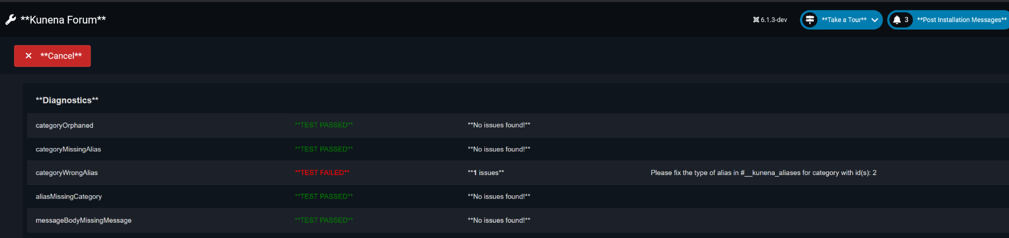

Question Diagnostics - categoryWrongAlias failed test
2 years 10 months ago #230319 by Indrit
Hello I run diagnosis just now and all TEST PASSED but one. here it what is says:categoryWrongAliasTEST FAILED1 issues1
How can I fix this?
Indrit

3 months 3 weeks ago #235125 by David Li
And what am I checking for? It would be great if at least the Kunena test would identify the specific categories that failed the test.
3 months 2 weeks ago #235137 by xillibit
For wrong category alias there in no autofix in the diagnostic, i have made a change which allow to see all categories which has the wrong alias instead of only the last one like actually. In the message box it displays Please fix the alias for category with id(s) : list of id : github.com/Kunena/Kunena-Forum/pull/10195
3 months 2 weeks ago - 3 months 2 weeks ago #235139 by David Li
Hi, installed today's latest update 7.0.8. I see 2 alias issues, but no detail on which 2 are bad. Should I look for the specific 2 in a different view other than Tools?  Not seeing any new "button" or hotlink or message box to get a list of the 2 problem examples.  I see a "1" on the far right side after the "2 allias issues" column.  But that "1" is not a hyperlink.
Last edit: 3 months 2 weeks ago by David Li.
3 months 2 weeks ago #235145 by xillibit
With this change :  github.com/Kunena/Kunena-Forum/pull/10199
It display the error message for wrong alias and i have imporved it to explain how to fix :
