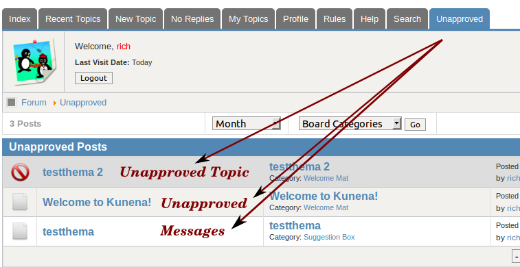

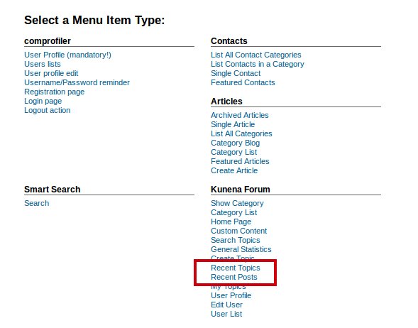

There are two different Menu Types.
The Menu Item "Recent Topics" shows only unapproved topics.
The Menu Item "Recent Posts" shows unapproved topics and messages.
