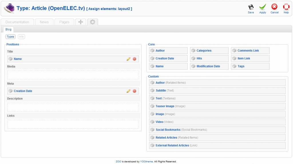

Managed to get the module to work. But I were bumped by the over excessive clutter the module displays.
What came to mind, as were are using the ZOO extension for our site. It has a really good way of controlling the modules output by styles. And something similar I would really suggest where done for Kunena as well.
Then you could change the layout in the back-end component of Kunena. Maybe have support for different styles to be used different part of the website.
I can only recommend that you check it out. Truly Kunena and its user would benefit mostly of such features.
P.S. If such thing were done, I can only imagine that the discussion bot would be un-needed, since you could only use the module with a set style to display the output as a "blog" or a "news"-source.
Here is ZOO:
