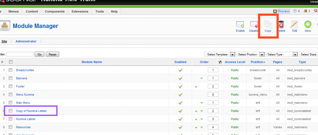

16 years 2 months ago #57771 by xillibit
With the Joomla! Module mananger, you can od a copy of the module and after you will haven't anymore this issue. Just select with the checkbox the actual kunena latest module and hit the button copy, then you will see a new module nammed copy of kunena latest, it's all and it's magic :) :
16 years 2 months ago - 16 years 2 months ago #57772 by mervyn
That is basically what I did and what caused the problem. I used "New module" to add another instance of the module and it produces the above mentioned error.
Fatal error: Cannot redeclare class modKunenaLatest in .../modules/mod_kunenalatest/mod_kunenalatest.php on line 25
Last edit: 16 years 2 months ago by mervyn.
16 years 2 months ago - 16 years 2 months ago #57774 by xillibit
You must not use new module function, but copy function like i have explained below
