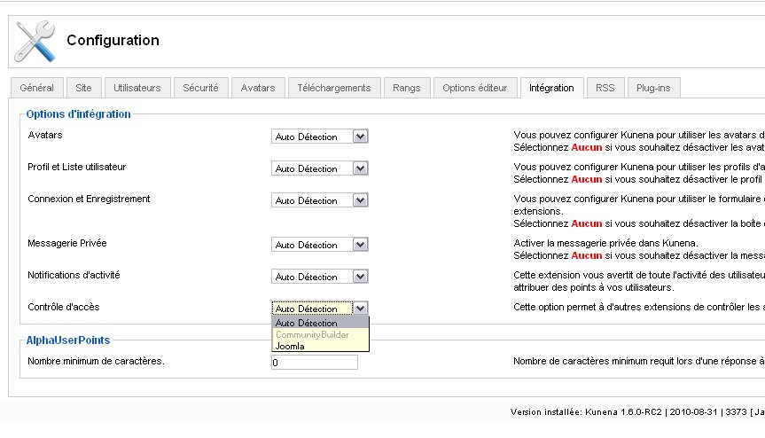

I have the same problem, I am redirected to an error page when post or reply topic.
"Auto Detect" is select but it don't work, I don't see kunena in the integration options, is it normal ?
Thank you for your help

You don't see Kunena in access control list (controle d'accés) because it's something manager by Joomla itself or ommunity Builder.
