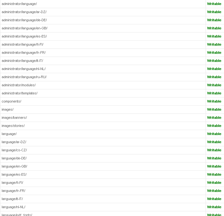

Language issue is not related to Kunena as Kunena only asks Joomla to load com_kunena. Joomla takes care of the rest. So you should probably ask this from Joomla forums or if you have JoomFish (or similar) from their forum.
English file may fail to install because of permission issues. Please unzip our main package -- you will find English installation file from archive. Try to install it by Joomla installer and look what happens..

Thanks for your reaction, i have tried to manually install the language file included in the kunena archive, generating the following error:
* It was not possible to copy the selected file.
* JInstaller::install: Failed to copy file: /home/admin/domains/cre8web.nl/public_html/tmp/install_4cac80466591e/site/en-GB.com_kunena.ini to /home/admin/domains/cre8web.nl/public_html/language/en-GB/en-GB.com_kunena.ini
I have also googled around a lot for similar problems like this, but i can not seem to find an answer.. Also i searched trough the joomla and joomfish forums but i can not find anything related to this problem..
