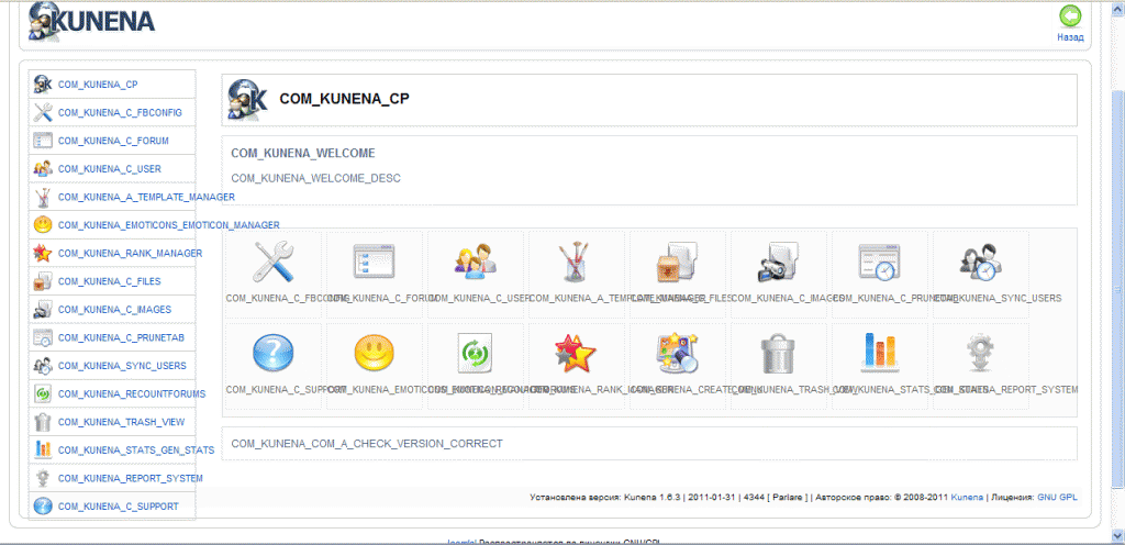

After upgrading to Kunena 1.6.3 from 1.6.2 there is a problem in the backend.
It seems that some language files are missing. Please help to fix it.

15 years 9 months ago #86450 by Matias
Replied by Matias on topic Re: Missing language files?
Well, russian language files got mixed up in K1.6.3. I believe you should look if you can find updated (or take&update older from K1.6.2) ones from somewhere.
