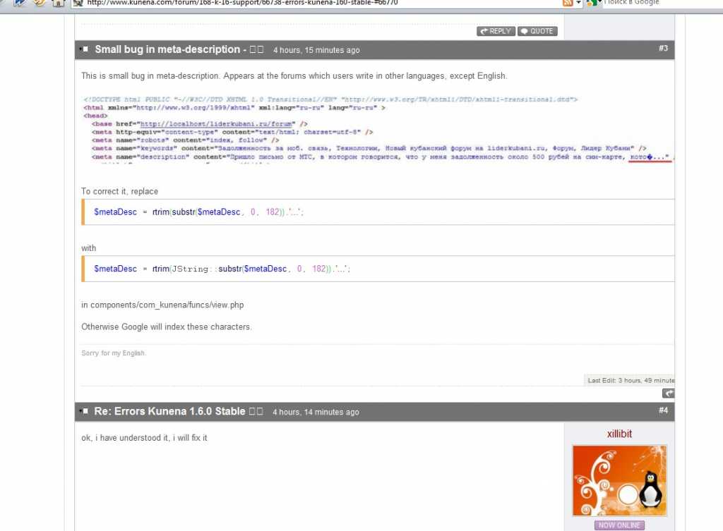

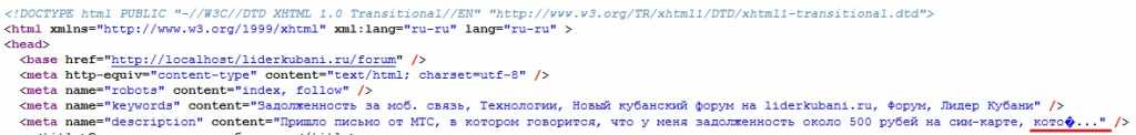

15 years 11 months ago - 15 years 11 months ago #66770 by ChaosHead
This is small bug in meta-description. Appears at the forums which users write in other languages, except English.
To correct it, replace
$metaDesc = rtrim(substr($metaDesc, 0, 182)).'...';
with
$metaDesc = rtrim(JString::substr($metaDesc, 0, 182)).'...';
in components/com_kunena/funcs/view.php
Otherwise Google will index these characters.
Last edit: 15 years 11 months ago by ChaosHead.
15 years 11 months ago #66771 by xillibit
ok, i have understood it, i will fix it
