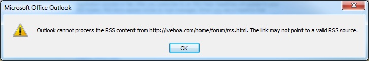

Our users are reporting that outlook is complaining about the RSS feeds.
Error message attached.
Rss url
lvehoa.com/home/forum/rss.html
Any suggestions would be very welcome.

16 years 2 months ago #59847 by williamhystevens
Cerberus,
Thanks for the response, We use sh404sef for SEF and have it enabled for Kunena. I will be bypassing it to see how that goes.
I think this issues is specific to outlook, the xml envelope looks fine and when I read the RSS feed in firefox it looks just fine.
I would love to get rid of the warnings you noticed, but the developers have not corrected them yet. We have one component that still requires legacy.
The RSS issue is more likely a sh404 and Kunena 1.6 issue since the only change made was kunena, the issues only started with 1.6RC1 the RSS feeds in outlook ran fine with Kunena 1.5x
Thanks again.

16 years 2 months ago #59856 by williamhystevens
Cerberus,
Thanks for the ideas but it turns out I am my own wost enemy....
I had Kunena set for
Registered Users Only = yes
This not surprisingly stops all anonymous RSS readers from working such as outlook.....
Thanks for the ideas......
