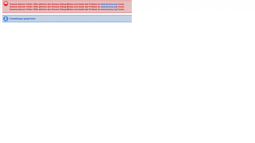

The first issue is, i can't edit the configuration. It tells me that its saved but its not.
I get the following error:
Its german, i translate:
Red: Kunena intern error, please activate debug mode and report on kunena.com
Blue: Successful saved.

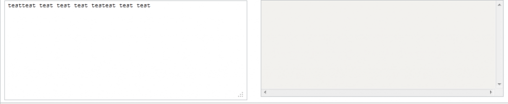

Another issue is, that i can't make a preview any more. In the beginning it worked perfectly but after some configurations i think (but don't know which any more >_<) it didn't work any more.
If i click on preview i get nothing, only an empty preview window:

1)uninstall kunena 1.6.2
2)install kunena 1.6.4
if its still not working.
go to your database and change it manually. *_kunena_config set debug to 1

Thanks to the better error report of kunena 1.6.5 i foundet the problem with the no-editable-config file.
Giving the mysql user "DROP TABLES" Permissions solved the problem. Didn't tought that kunena uses this when saving the configuration...
But the problem with the preview is still there, i deleted everything of kunena an installed it again, there is still no preview. Could you tell me if there are also some mysql permissions needed or could it be because of APC php.net/manual/en/book.apc.php ?
Do i need mootools for the preview or something like that?
Best regards
Best regards
15 years 1 month ago #105377
by 810
Replied by 810 on topic Re: Can't edit configuration and no preview
yes please enable mootools upgrade on plugins
