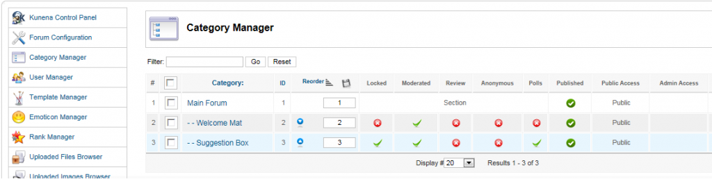

15 years 1 month ago #93194 by 810
Go to the backend- kunena- Category Manager
Uncheck at the category the locked section.

15 years 1 month ago #93196 by sanam
Thanks for your help,
I did all of the categories are ticked, means not locked
But Still registered users can not post anything, Except Admin
