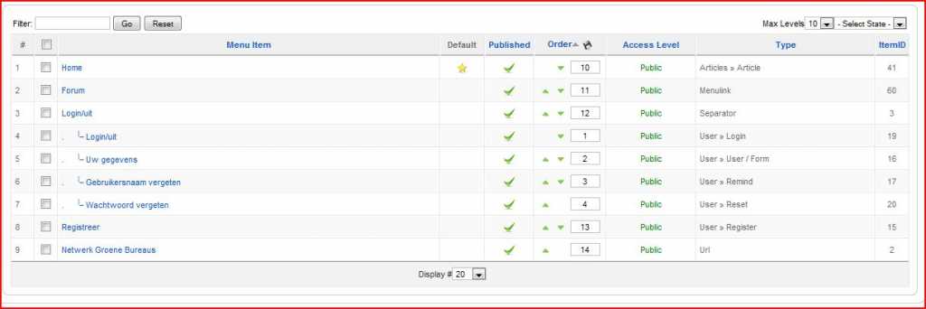

15 years 10 months ago - 15 years 10 months ago #69543
by micrantha
Replied by micrantha on topic Re: Warning: Using direct link to Kunena component. Redirected to menu item in /forum/index (ItemID=43).
Thank you for your quick answer.
I have attached screenshot of backend main menu setup.
When you want any other information I will give it.
ItemID 42 is from Kunenamenu, item 'Forum'
43 is from the subitem 'Index'. I now have bsic configuration, with the warning:
Warning: Using direct link to Kunena component. Redirected to menu item in /forum (ItemID=42).
Hope you can help me on; I have 2 subdomains in development for which I have to set up a forum, and both have this warning.
Template is based on Joomlart JAT3-framework.
Regards,
Micrantha
Regards,
Micrantha
Last edit: 15 years 10 months ago by micrantha.
15 years 10 months ago #69547
by haithun
Replied by haithun on topic Re: Warning: Using direct link to Kunena component. Redirected to menu item in /forum/index (ItemID=43).
Did you tried to change the menulink to the index tab so it points direct to item with index 43?
15 years 10 months ago #69548
by micrantha
Thank you. Yes I did. Same stubborn warning...

15 years 10 months ago - 15 years 10 months ago #69598
by micrantha
A follow-up of my earlier posts: I think I found a work-around which keeps away the warnings.
I depublished the menu-item 'Forum' (alias 'forum') in Main Menu.
Next I created a new menu-item 'Forum', with different alias-name, and menu-item-type 'External link'.
The URL I used points to the Main Menu Forum-item I depublished: http://domainname/forum
Now this link to the forum opens the forum without warning, and forum seems to function OK.
If anyone can explain why this way around is necessary, please write it here.
Thank you.
Regards,
Micrantha
Thank you.
Regards,
Micrantha
Last edit: 15 years 10 months ago by micrantha. Reason: clarification
