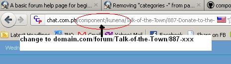

I want the url of my kunena forum to appear like here in kunena.org instead of using mydomain/component/kunena/xxx
Where and what edits should i make?
I already have my backend settings not to use categories.

Please read What information should I include when I ask for help (including how to post my configuration report)? . You edited your configuration report.
On the basis that you have not included everything that is contained in an unedited Kunena configuration report, I'm guessing: I think you have not properly setup your Kunena menus. That's what I think. I think you need to learn how to setup your Kunena menus. I could be wrong but I'm relying on the incomplete Kunena configuration report that you posted; if you would like to post us all the information that's in the config. report, maybe I'll have a different assessment of the problem.
Please read How do I restore my Kunena menu?

I have now set my kunena menu manually because I didn't find anything there at first. It seems to be working right except that I cannot view or publish it because I cannot find the kunena menu module like the one you posted here, www.kunena.org/forum/159-k-16-common-que...t=10&start=110#92819
I think it's now off-topic but where can i get that module? If this would info would help, I used the kunena-importer to migrate from phpbb3 to my current kunena installation.

You need to fix up how you have created your menu links. I suggest that you should read [How do I restore my Kunena menu? on our FAQs page.
