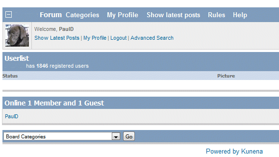

16 years 8 months ago - 16 years 8 months ago #43361 by Jay44
Thanks Matais and sozzled for your care and attention!
I though there was a setting to "Show User List" - which I had set to no.
The result of this was that if you clicked on the userlist link that appeared in the stats at the bottom of the main forum page - you just got a message "userlist not available".
I can't find this setting - I think it was a Fireboard setting!, but I have altered the setting in the Kunena Configuration in Plugins - userlist.
- I have set the number of rows to 0
The other fix I came up with was to chage the alias for the page that brings up my forum on the site. The page found via a google search was left over from 2008 when a previous moderation had the "Show userlist" set to yes. Because the SEF link name was the same, then the old result - mysite.com/forum/userlist?start=270 still worked and bypassed the other forum settings.
"forum" is a menu alias - so with this changed, the old google result now gets a 404
It was a bit of a shock that this old search result would produce the list!
Anyway - these fixes have worked to prevent access to the userlist.
