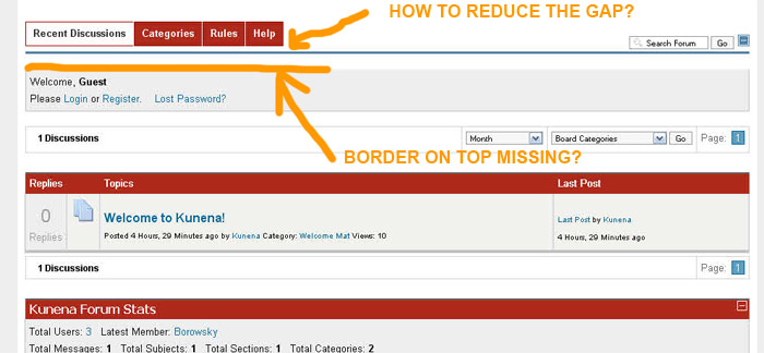

i have a problem with my template modification.
Everything is going well, but i have two small adjusments i won't can handle:
1.) there is a gab betwheen the toolbar an the line under it. How can i reduce it. Could not find this part in firebug
2.) i can't see any border on top of the "hello guest" box
Any idea? Help would be very fine.

I think the problems are caused by your Joomla site template - I could be wrong. Your Joomla template TABLE or TD definitions have extra padding. Thank you for the image that shows what the problem looks like; a link to your website would probably get to the cause of your issues quicker.

The problem with Kunena at your website is caused by your Joomla template. At around line 70 of your Joomla CSS (core.css) you have the following rule:
p, dl, hr, h1, h2, h3, h4, h5, h6, ol, ul, pre, table, address, fieldset {
margin-bottom:20px;
Remove this rule.
Alternatively, you could define the rule another way which might work for you:
p, dl, hr, h1, h2, h3, h4, h5, h6, ol, ul, pre, address, fieldset {
margin-bottom:20px;
margin-bottom:20px;
Remove this rule.
margin-bottom:20px;

Fixed the missing top border, but not the gap?
