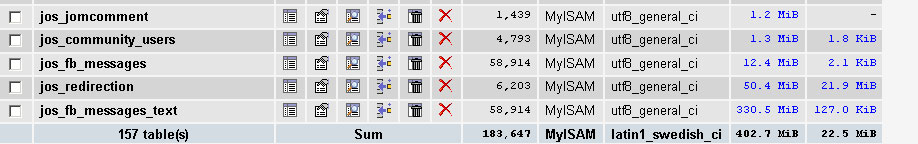

I recently upgraded one of my forums to Kunena 1.5x, and realized the database was nearly 400 MB. Currently jos_fb_messages_text is taking up almost 300MB, and I have only about 2500 real posts. I noticed my stats say I have over 50,000; which I assume is from spam posters.
My question is, do posts/threads that get deleted actually get removed from the database? Or are they just disabled from being viewed? Also, do avatars, images, and attachments get stored in the database? What else would cause mine to become so large with less than 3,000 posts?

What are you using to calculate the space used by the database?
Either you have 2,500 records or you have 50,0000+ records and I would like to know what we are discussing. If Kunena gives two different reports, can you please show me where: maybe a screen capture with the relevant areas highlighted?
Databases grow. When you delete records from databases, you don't normally get any release of disk space. To reclaim this "lost" disk space, you need to compact the database. Most database management software (like phpMyAdmin, for example) have features for compacting the database.

Space is being calculated by phpmyadmin, which reports the referenced table is over 300MB. It you goto the site (PM sent), you will see there is 50,000 posts (This is reported at the bottom by Kunena). If you actually look at the numbers reported by the subforums, you will see it is significantly less.
When I browse the database table, there are over 50,000 records shown. This makes be think that even after deletion, the records are staying in the database.
16 years 3 months ago #55689 by rocketman007
Phpmyadmin screenshot added.
