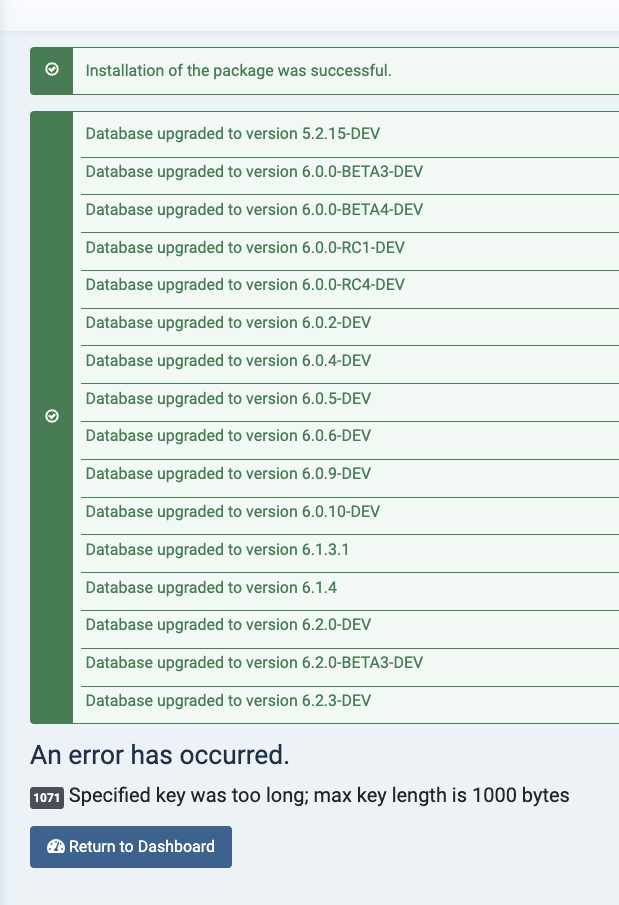

9 months 2 weeks ago - 9 months 2 weeks ago #6 by AlexRag
I don't recall. Should install/reinstall to try again and see if I get that message?  [UPDATE - I reinstalled and saw this error message when I accessed the dashboard

9 months 1 week ago #7 by xillibit
So now you Kuena tables are updated. There should be an extra upgrade step with the update message to 6.2.4-DEV so the error message could coming for this last step. This last step converting columns of tables in utf8mb4 for which ones which aren't in this format.
Your previous errors have disapeared now ?
9 months 1 week ago #8 by AlexRag
I'm unsure which error you mean, besides the one shown above.
When I reinstalled Kunena the above error continues to appear. I also can't get to the "Report Configuration" settings
And on the front end, I still see this error message:
"0 Cannot use object of type stdClass as array"
I suspect this has something to do with the table conversion you mentioned. If it's failing is there a way to manually process that column conversion?
