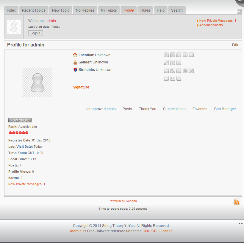

Basically the buttons are not clickable and when you edit the profile in mozilla or chrome the bottom portion of that page does not show
Ok I looked a little deeper and it seems I do have the post problem where you do not have the font and embed links buttons above the emoticons but everything works when I use IE would that mean that it is the same mootools problem or is this different?
This problem was solved by setting enable mootools to no for my Joomla template Yoolevel 1.50
